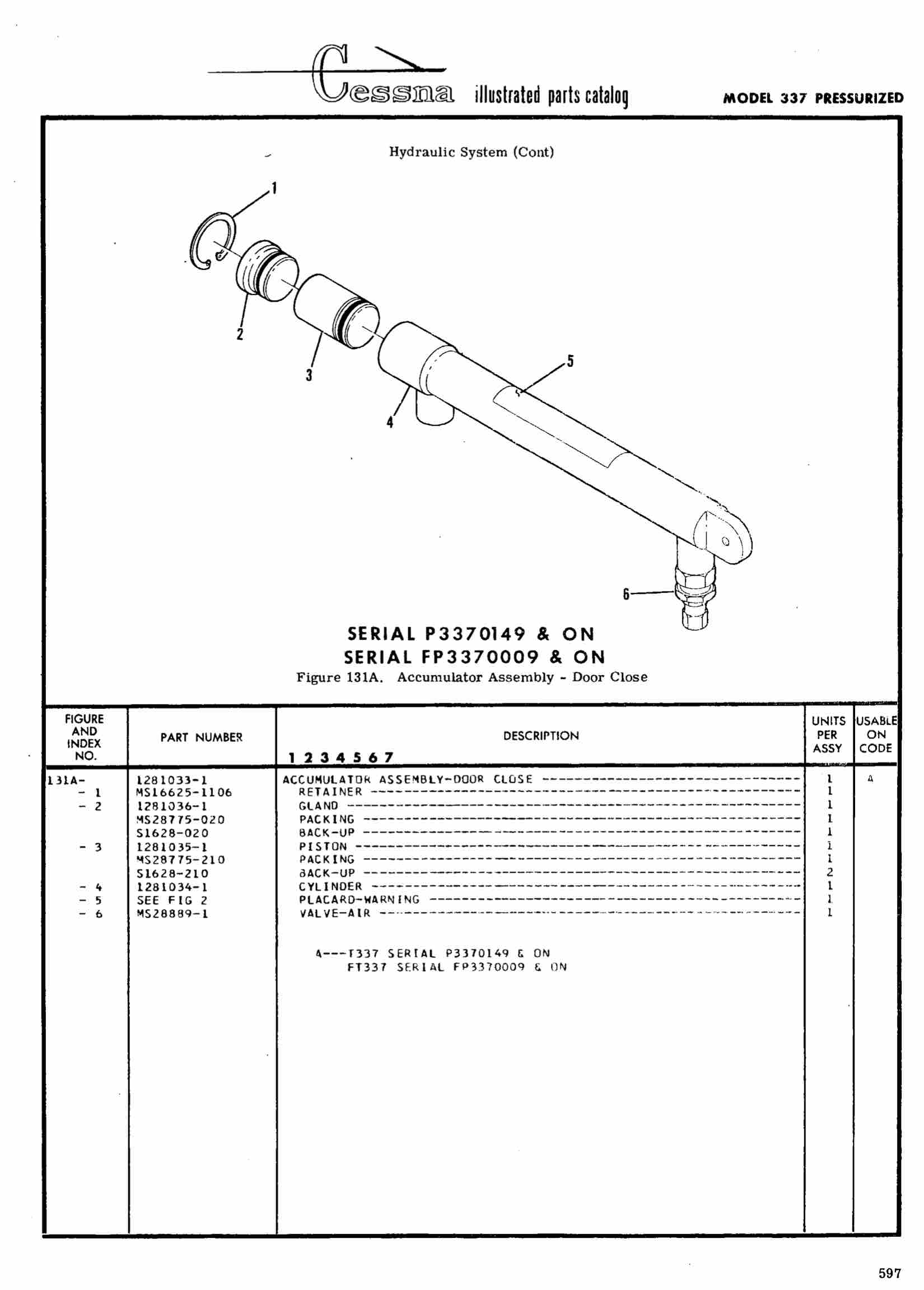

Thank you guys for your response. With the interior out and up on the jacks first thing we did was to service the accumulator. Finding little or no pressure we added the 500# nitrogen charge. While we planned on the whole bleeding scenario proposed, my A&P wanted to cycle the gear, check timing and door closing before going any further. It went perfectly!! 12.4 seconds and all doors closed tight. Thanks again.
