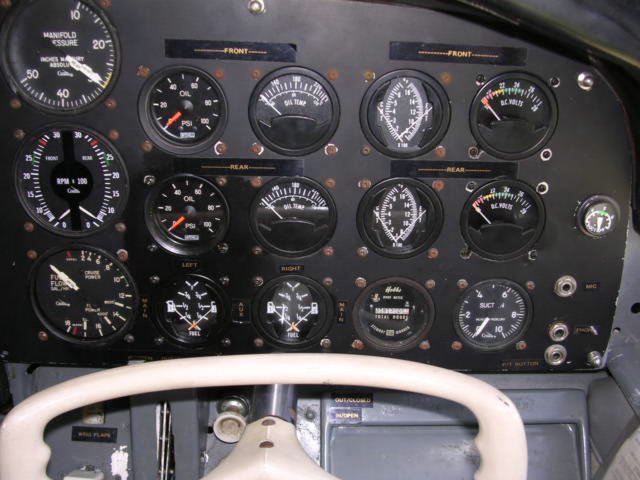

Question about Vac pumps. How do I test the rear and the Front Vacum pumps? It seems the indicators work the same when one engine in on and the other is not??????

Francisco,
Are you familiar with those two small red buttons on the lower section of your vacuum gage? When you start one engine the associated red button for that engine's vacuum system should disappear. Actually, if the vacuum source is working right the red button 'retracts' out of view and the gage should indicate the value listed in the limitations section of your POH. If by chance you start just one engine and both of the buttons disappear from view, that would suggest a defect in the vacuum manifold check valve which is located above the co-pilot rudder pedals. So, the easiest way to check the system is to start up either engine and look at the gage and the associated red button to see that it retracts out of view. Then shut down that engine and start the other, checking that the other red button retracts from view and you're getting the the proper value. Your Cessna Service Manual has a section on this in the utility/instruments section.

Dear Skyking, thanks for your responce to my question as to how to check for vacunn on the skymaster, How ever my 336 does not have the red buttons you are reffering to here is a pic ture of the right side of my panel the vaccumm gauges are on the right ( one small One Big)
