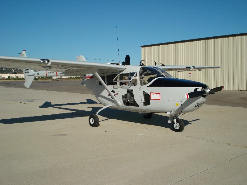

Good job.
Beautiful airplane, as well. I resized it for you.
