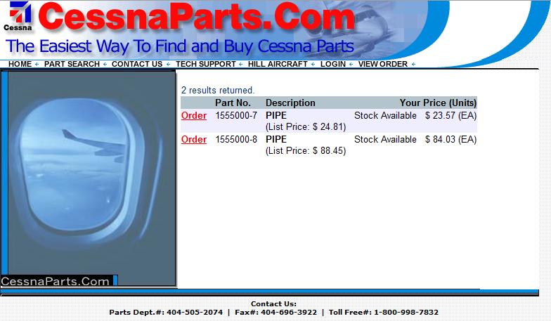

Tony
The -7 is the left and -8 is the right.
These part numbers fit from 65-72.

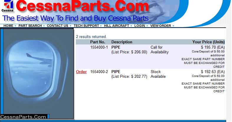

Tony
These part #'s fit 73-76
-1 is left, -2 is right.
Hope this helps.
