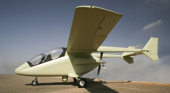

Unread 04-20-12, 09:35 PM
I prefer the more refined version myself
Unread 04-21-12, 12:56 AM
turbonut51 turbonut51 is offline
Join Date: Apr 2012
Location: calgary
Posts: 5
turbonut51 is on a distinguished road
Very nice but where do you store the 2nd engine.
What is that aircraft called, looks military prototype.
