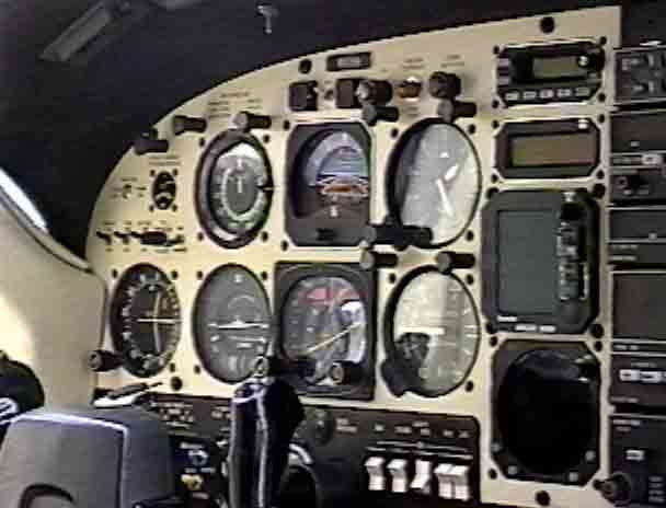

Unread 09-29-02, 04:59 PM
Location: SF Bay Area
Posts: 138
Argus Panel Picture
Skyking,
This is the best picture I have of my old panel. It's captured from a video tape, so the resolution is pretty low. This was an early Riley conversion and I've seen this Argus placement on many others. It is a good position for it to be installed (probably any place up or down on the right side of the pilot's panel would be good).

Argus 7000
Kevinmcdo,
Is your 7000 a monochromer or color unit... I see you have the RMI attached... How much for the RMI adapter for these Argus units?
SkyKing
Unread 09-30-02, 03:18 AM
Posts: 138
The picture I posted was the Argus 5000. The 7000 I have in my 210 is monochrome. A friend had the 700CE in his Mooney and was very excited about how color decluttered the screen.
My 7000 was installed around 7 or 8 years ago and I don't really remember the cost of the RMI, but I will take a wild guess and say it was probably something like $1,500.
