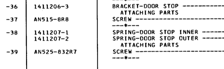

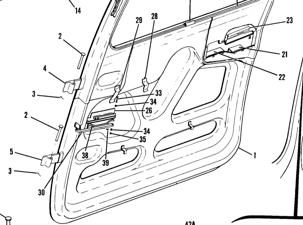

The original mechanism works pretty good but most of the parts are worn out if it doesn't stay open for you. This design allowed the door to stop and stay put at about 80% open and then the next cog opened the door beyond 90 degrees and held it there. Not sure about parts or repair but might be worth a look. Mine still works.....

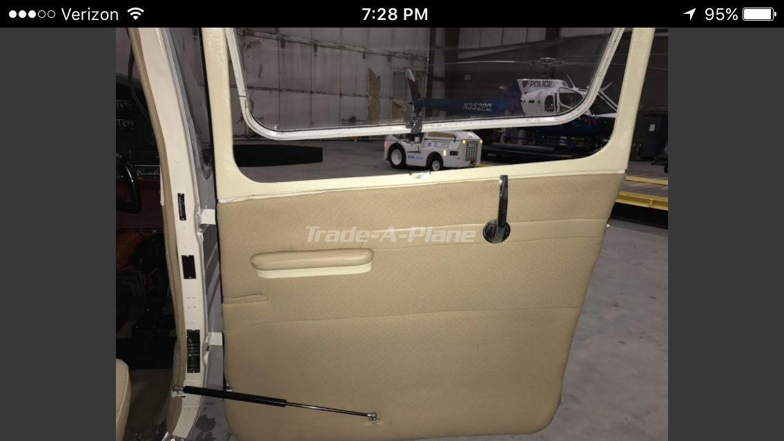

Trade-A-Plane pictures
Here is a picture of a door steward on a C337 that is for sale on TAP. Registration is on the site...wonder if we could find the 337 for installation...

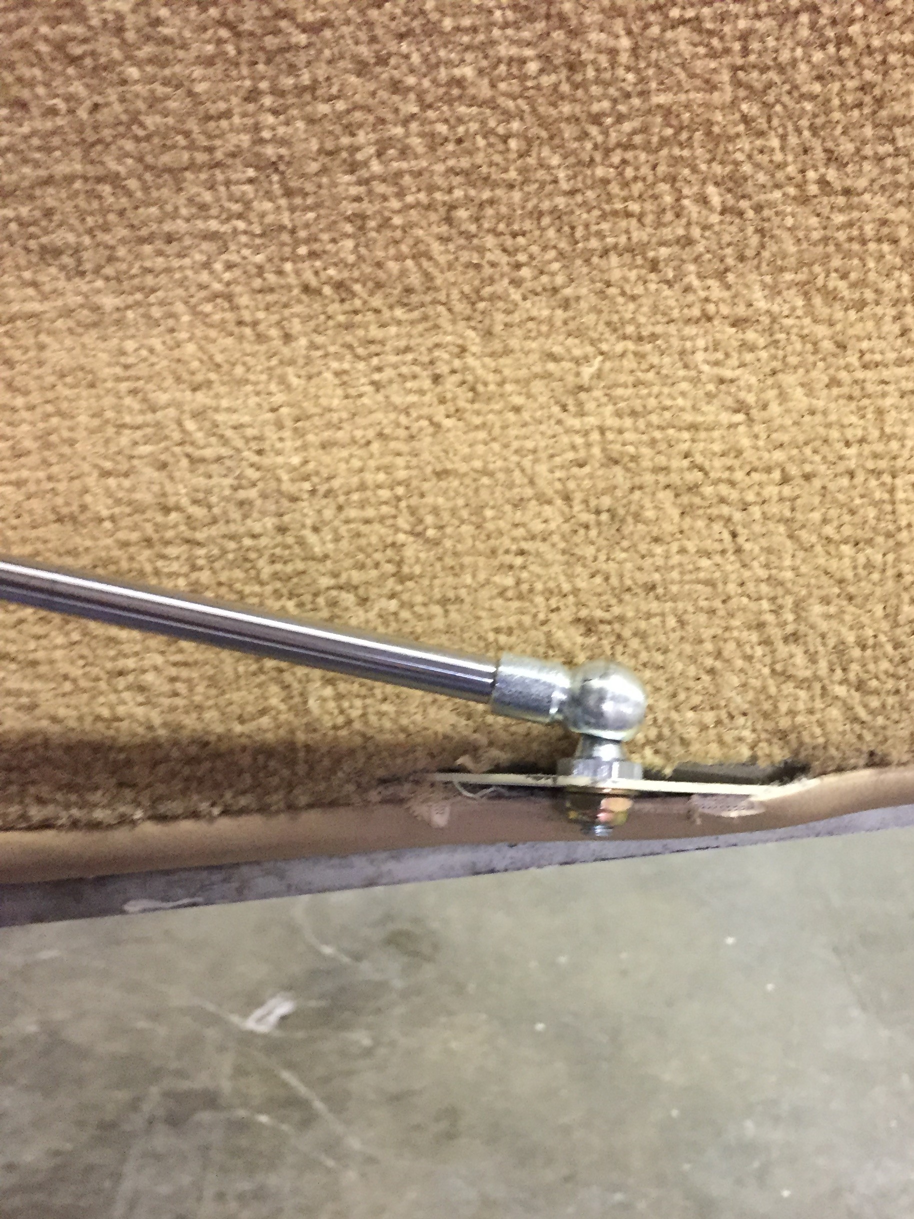

I purchased the door steward at MTN View Aviation. They were very helpful and they also had previous 337 forms that had been approved. My mechanic did a good job with the installation and it works excellent. Mine has now been approved.
