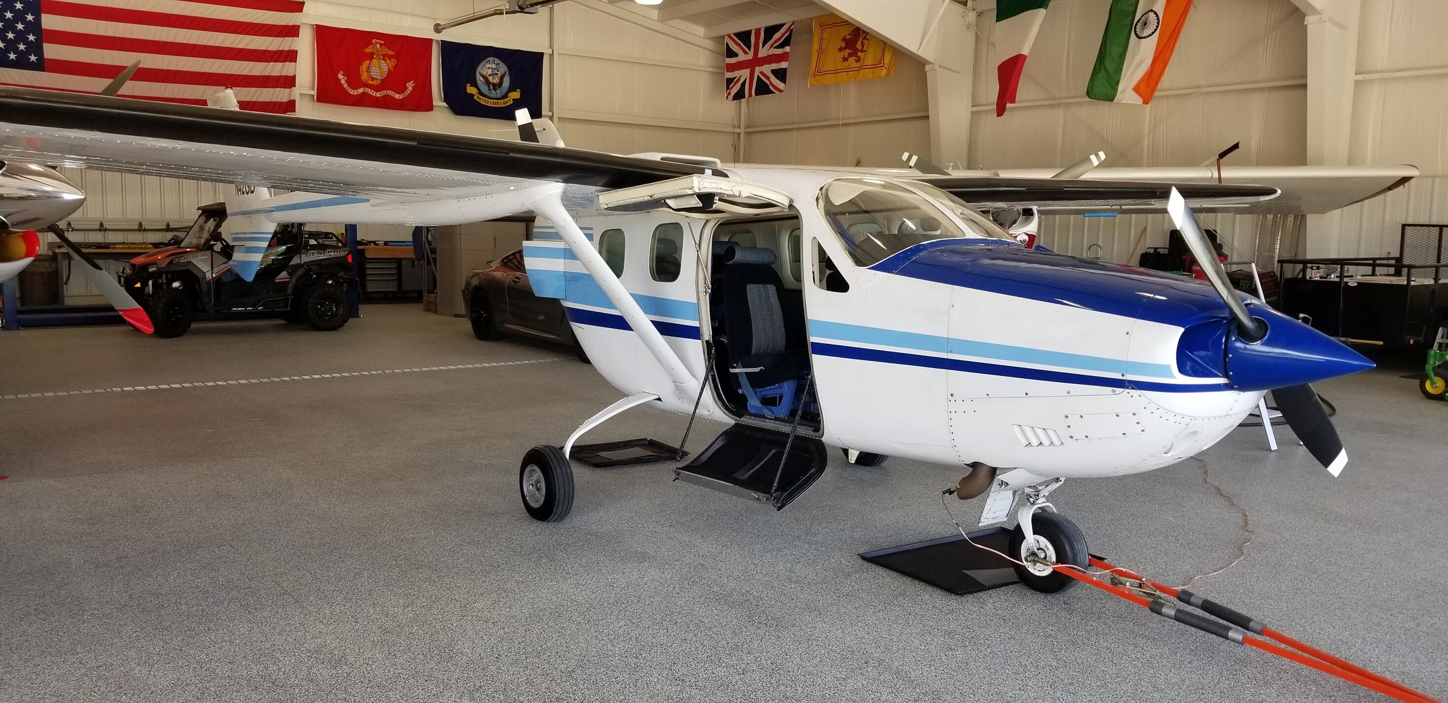

Can't for the life of me understand how to post photos here. None of the photo options I'm used to seeing in other forums! And most of my pics exceed the 1MB limit.

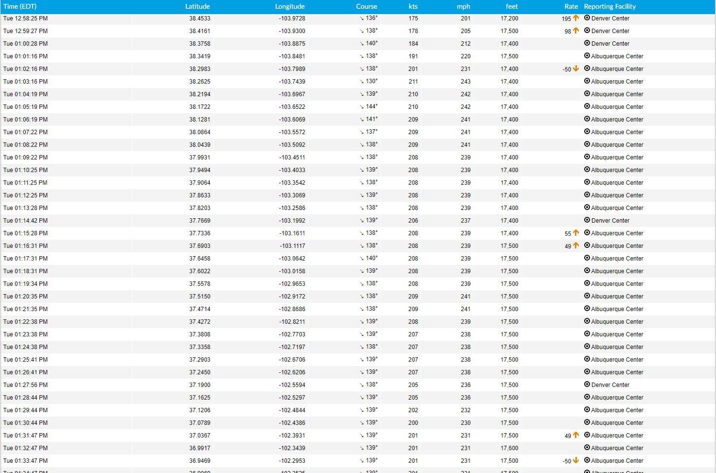

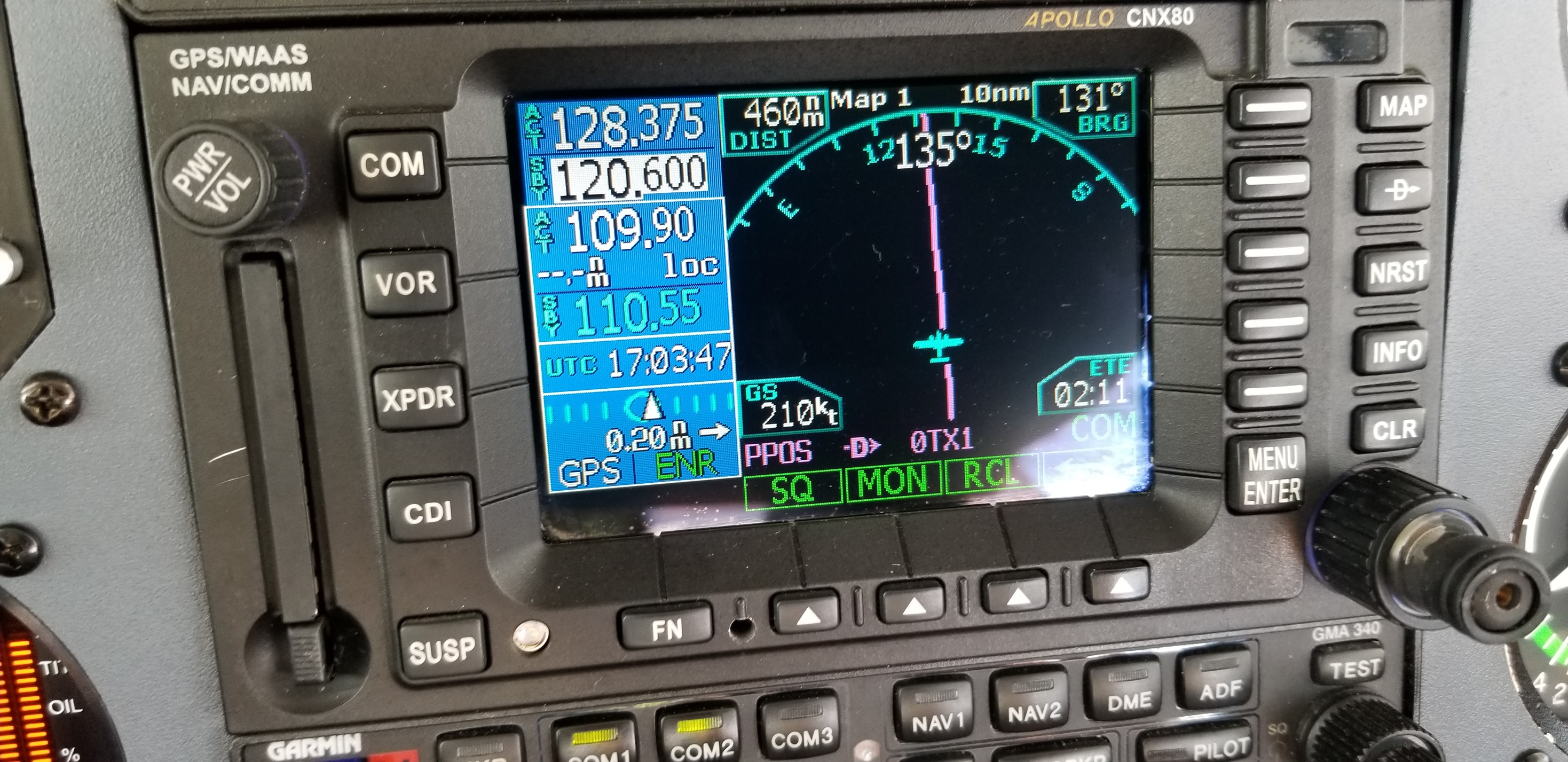

Here is a pic of the CNX80 showing 210kts. I also attached the speed/altitude printout from the flight.
