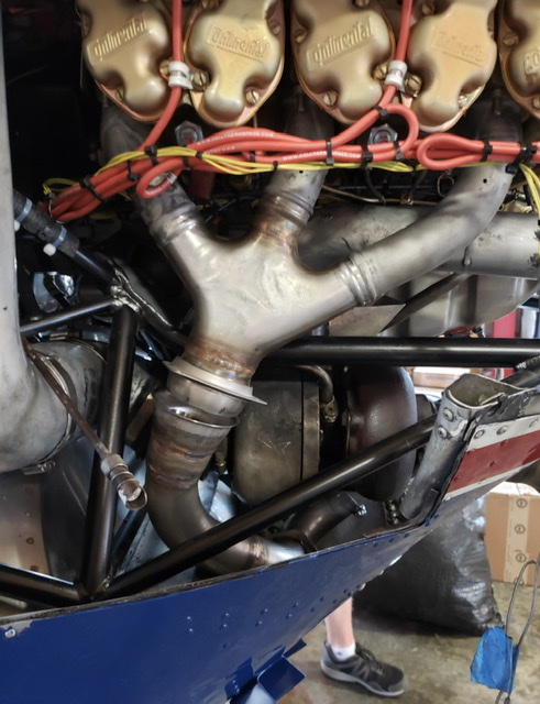

Howdy guys,
I recently overhauled my rear engine in my pressurized 1973 T337G. When my IA removed the exhaust system he noticed an excessive high load on the bolts used to attach the system to the engine. When we went to reinstall the exhaust stack we decided the amount of “torquing” on the system was excessive and must not be either a) installed correctly or b) the pieces are incorrect. We replaced all of the parts using Acorn but we had the same poor fit issue with their parts. If everything is on correctly, we have a misalignment at the pilot side collector (see pic). Are we missing something?
Scott

I am finishing mine all parts are also Acorn. You should be able to pull the ball joint half up and bolt it in with the 3 bolts. Check all the rubber mounts in the turbo bracket that attaches on both sides of the engine.

74 model, had to send a few parts back, number 3 riser did not fit to the collector correctly, I would say loosen everything up, attach the ball joints and go from there. Make sure the rubber mounts are not worn out.
This would include loosening the bolts on the turbo to the main turbo bracket, there is some play there. All parts including tailpipe need to be on and loose.
