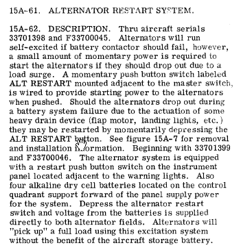

From Page 15A-23 of the service manual - Does this help?
