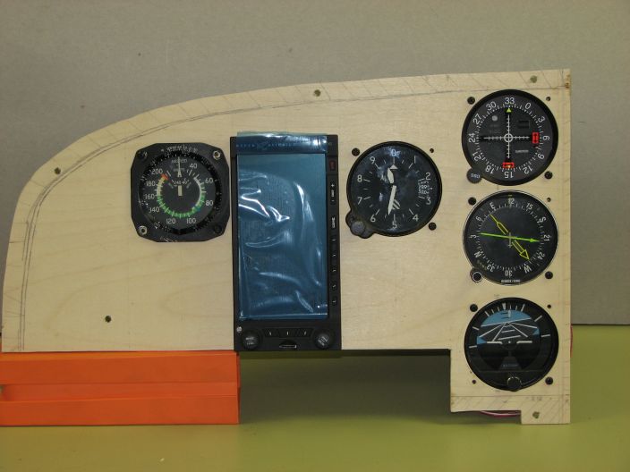

This is what the panel is going to look like so far. Again, the ADF and attitude instruments should be reversed.

Hi All,
Had the Aspen Pro istalled about two months ago. Fabulous piece of equipment. Everything worked as advertised right from the first flight. Best aviation invention since the wing!
I made one error. Notice in the mock-up panel in the photo submitted by Jakes Dekkers, that the Aspen is offset about 1.5" to the left of the control wheel shaft. This is because the Aspen fits into the hole left by removal of the attitude indicator, and on my ship and, apparently, Mr. Dekkers', the AI is not centered. over the shaft. Once the Aspen is installed, it's such a Christmas tree, with all the glowing colors and wealth of information beautifully and compactly displayed, the off-center position of the unit seems really assymetrical and weird.
I had an aluminum panel overlay made up and could have changed the layout slightly to achieve symmetry, had I noticed the problem beforehand. If you're going to spend the money, you want a nice-appearing panel, not one that's lop-sided. I plan to have mine redone at some point in the future.
Got rid of the super-junky, brittle and cracked plastic Cessna overlay in the process.
Next dream project: getting rid of the rectangular 1948 Studebaker engine instrument and fuel gauge cluster. Worst thing in the airplane in appearance and function.

Originally Posted by GJ Humphrey View Post
Notice in the mock-up panel in the photo submitted by Jakes Dekker, that the Aspen is offset about 1.5" to the left of the control wheel shaft. This is because the Aspen fits into the hole left by removal of the attitude indicator, and on my ship and, apparently, Dr. Dekkers', the AI is not centered over the shaft. Once the Aspen is installed, it's such a Christmas tree, with all the glowing colors and wealth of information beautifully and compactly displayed, the off-center position of the unit seems really assymetrical and weird.
It is a very valid point. Actually, we were paying a lot of attention to that. We were torn over the two choices we had: (a) centre the PFD over the steering column, or (b) centre it over the amber warning light directly beneath it. Option (b) made more sense for 2 reasons: (i) the basic structure of the panel support allowed for it very easily, and (ii) visually it looked better when centred over the yellow warning light. We also pasted real-life size pictures of the MFD's either side of the PFD, and when the area covered by Aspens is bigger, the little offset is almost not noticeble.
It's weird, but in the "old" steam gauge configuration everything was also 1,5" off to the left - I did not even notice it then.
