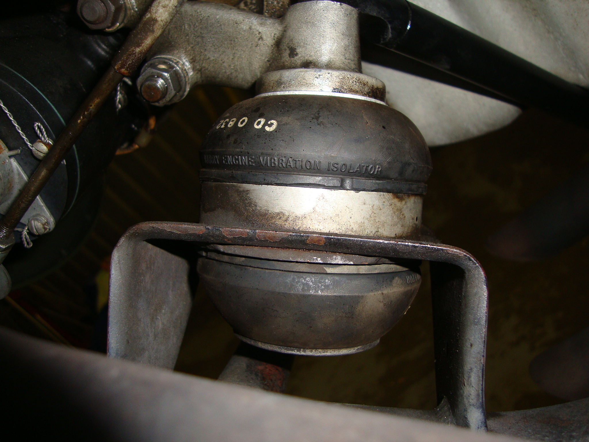

Unread 10-12-09, 01:42 AM
Posts: 510
Here's a pic of a new mount on the rear engine.
