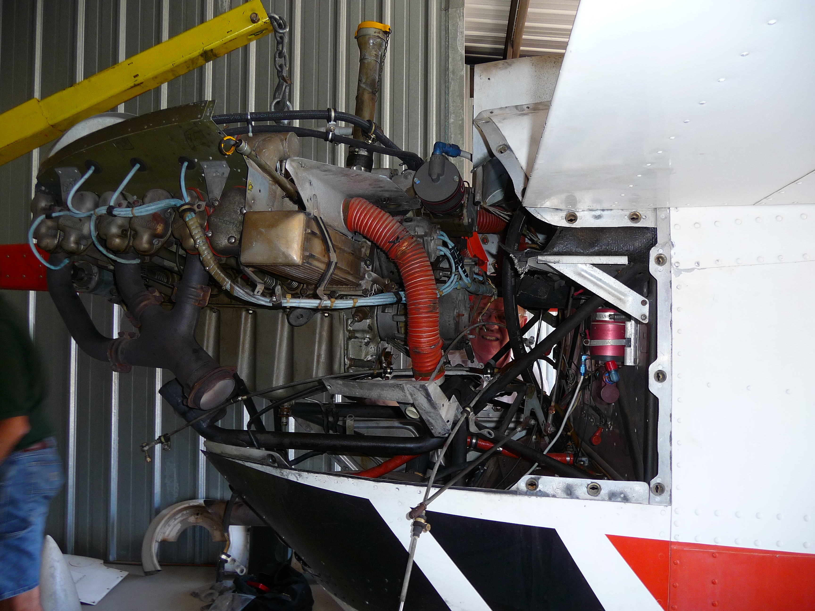

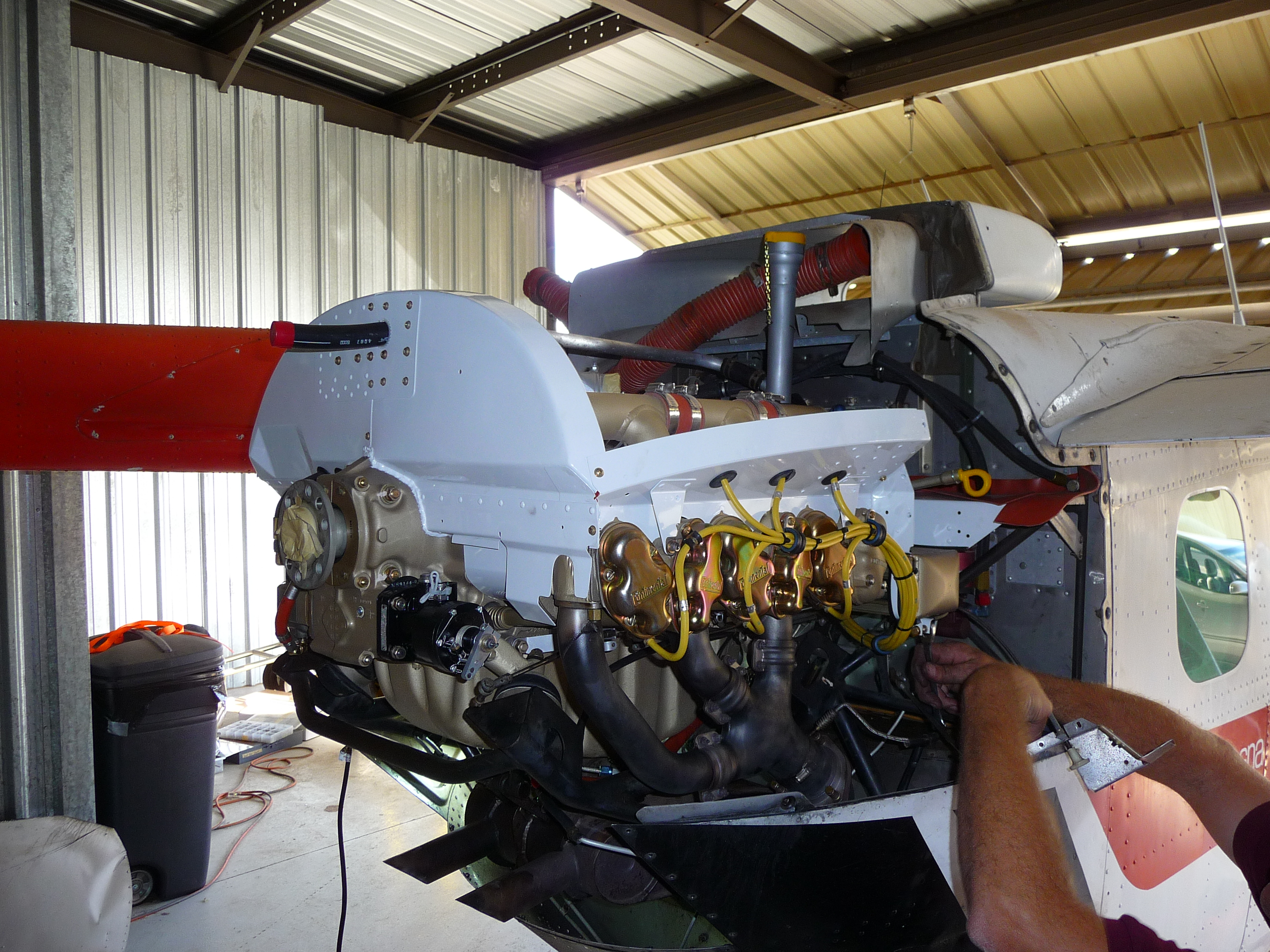

Dale, The old engine is out and the new is in (see attached pictures). Right now, the old engine (and starter) in in Greeley, Colorado at Beegles Aircraft. I'm going to be seeing the Beegles engine mechanic today. I'll talk to him about the swap and let you know. If this works out, I'm not looking to make any money off the deal, just cover the shipping and mechanic. Also consider, my old starter is about 32 years old. It is the original starter that came with the aircraft from the factory. It has spent most of it's life sitting in a hanger, and the engine only has about 800 hours, but 32 years seems like a long time for a starter. I have not had any problems with it. Todd
