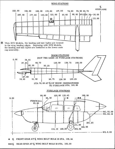

According to the NTSB the wing seperated at Sta. 177 .. Out of interest, I am going to establish Sta. 177 on 74DN this morning ... I have install data on ?? tip tank installation unless it has been disgarded ... Will let all know my findings ...
74DN super skyrocket ... From first hand experience with the acceleration potential of my airplane @ less that 1000 fpm dive @ 2300 / 32" M.P... Roger's comment is my opinion is right on ... RED LINE + ...
I don't know if it is practical for you to do so, but could you place a marker of some sort on the wing, coinciding with Station 177, and then take a picture.
It would help all of us to visualize where that is, in relation to the strut and it's attach point.
Larry
  #24
Unread 02-24-10, 10:23 PM
Tony
See attached diagram for wing station's.
