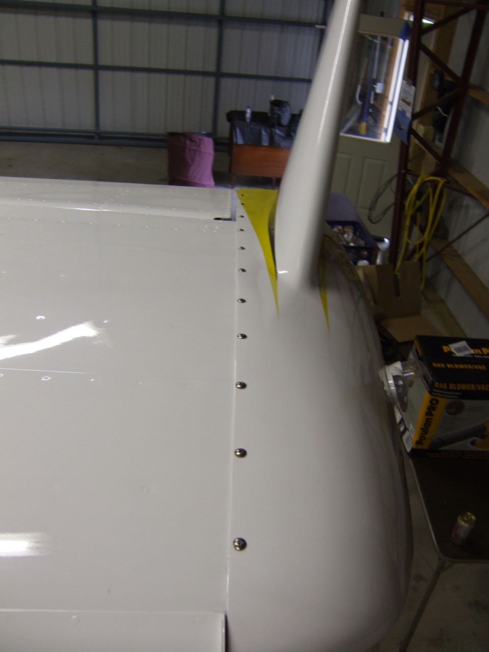

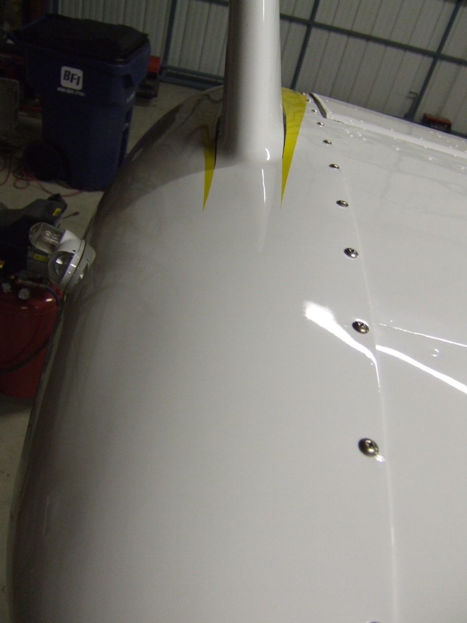

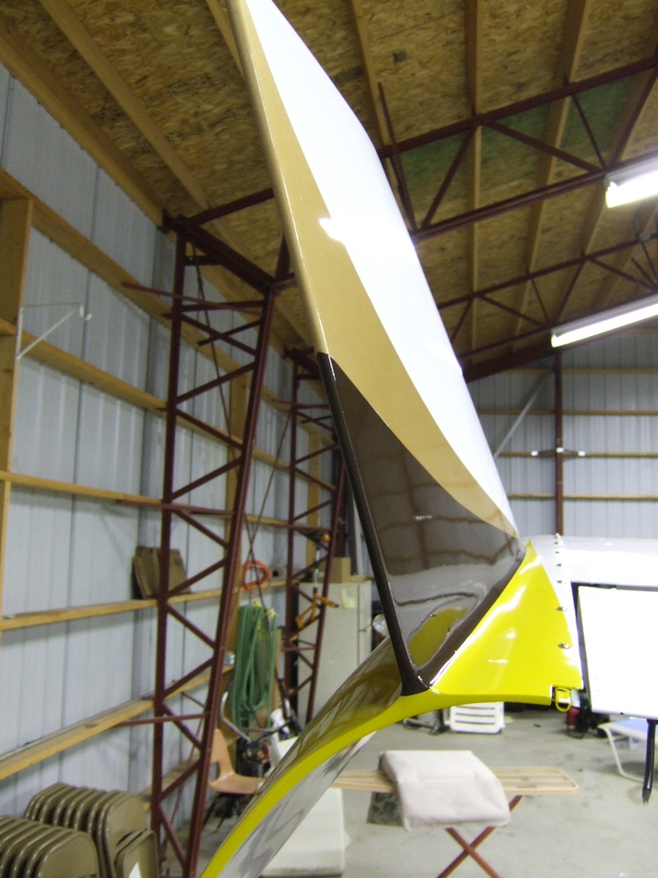

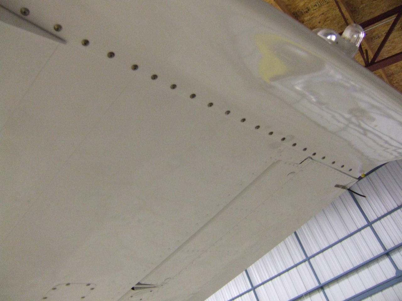

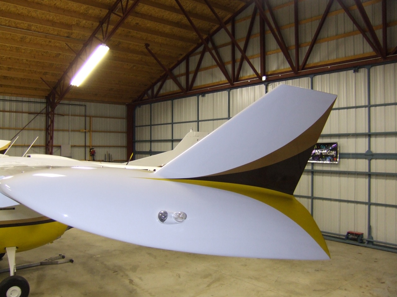

Horton Stol Wing Kit and Aviation Enterprises Lightning Winglets. Is that considered a stacked mod? Guess so. When installing the winglets I first tried to use a sheet metal screw between the original screws but did not like the results. I installed rivnuts on all fasteners and it just is much better mounting process.

In my opinion the "winglets" give the airplane a goofy look. And there is no aerodynamic advantage to have them.
