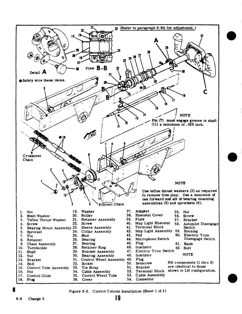

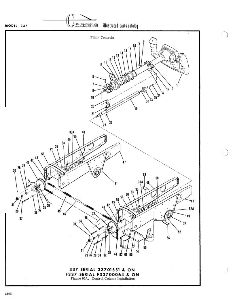

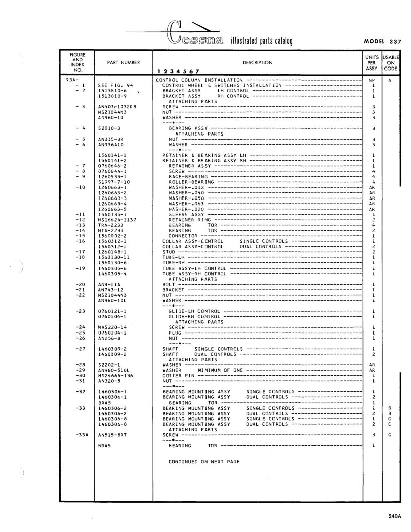

What symptom or indication are y’all seeing that needs yoke bearing replacement as the fix?
With my yoke aft, I can move the control wheel in a pretty good circle. The pilot side is way worse than the pax side which would make sense. I will get a video in the next few days.
I reached up back toward the firewall to the Roller (20), Retainer (21), and Sleeve Assembly (23), and they were rock solid. All the movement is back at the panel in the Bearing (30) and Bracket (29) Assembly. Numbers are references in Maintenance Manual, I wish the Parts Manuals used the same figure numbers!
As a note, there are no Rollers (20), Retainers (21), and Sleeve Assemblies (23), in the Textron parts chain. That's a big deal, there are a lot of Cessna models that use these assemblies.
