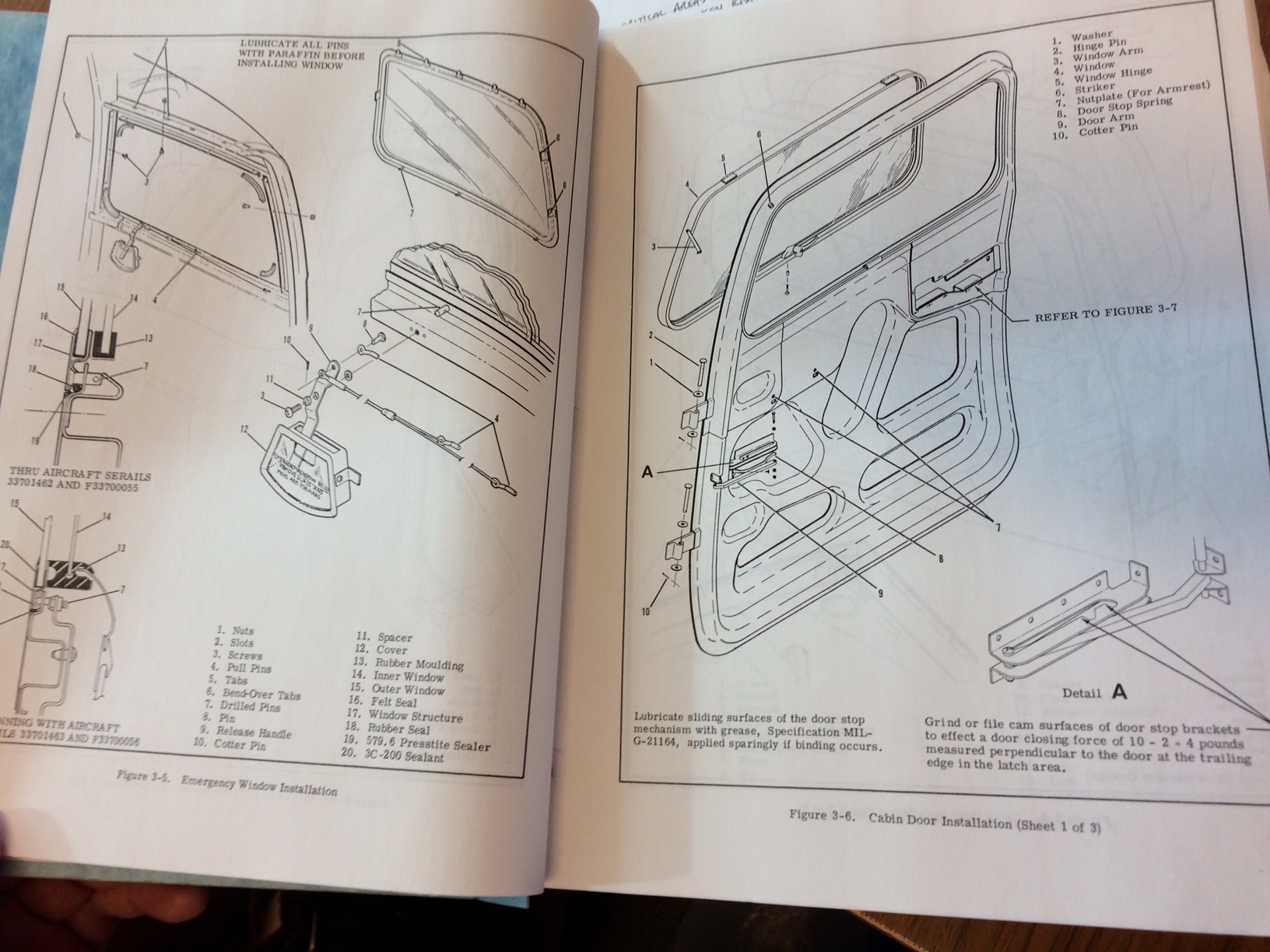

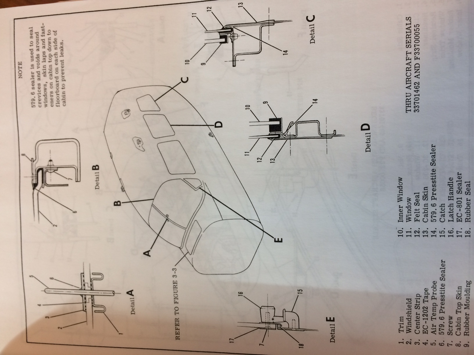

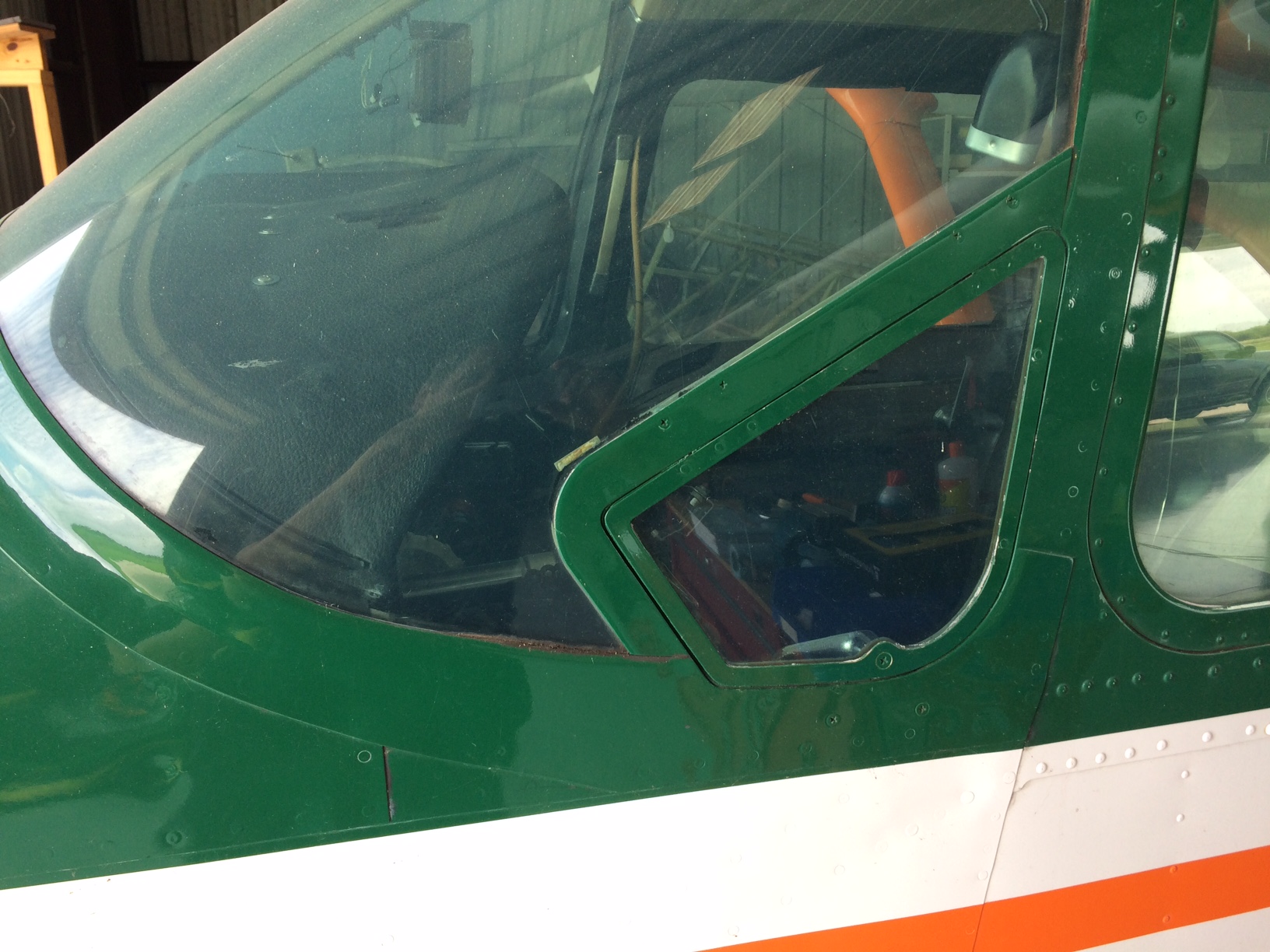

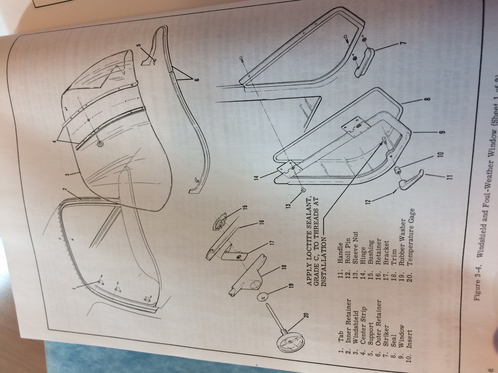

A few misrepresentations...
The Skymasters (non-pressurized) have one door - located on the right side (Starboard).
It has the typical Cessna opening window that is hinged on the top. The baggage door, also on the right side, is simply that - a baggage door, not an exit or entry (except for maybe a small animal). On the pilots side (port side) of the windscreen, there is a small vent window that opens (a little bit of airflow) and an emergency exit (pilots side window). It is only an emergency window and is not hinged - it is not used for ventilation.

Photos
Jim - some reference photos for my last post.
