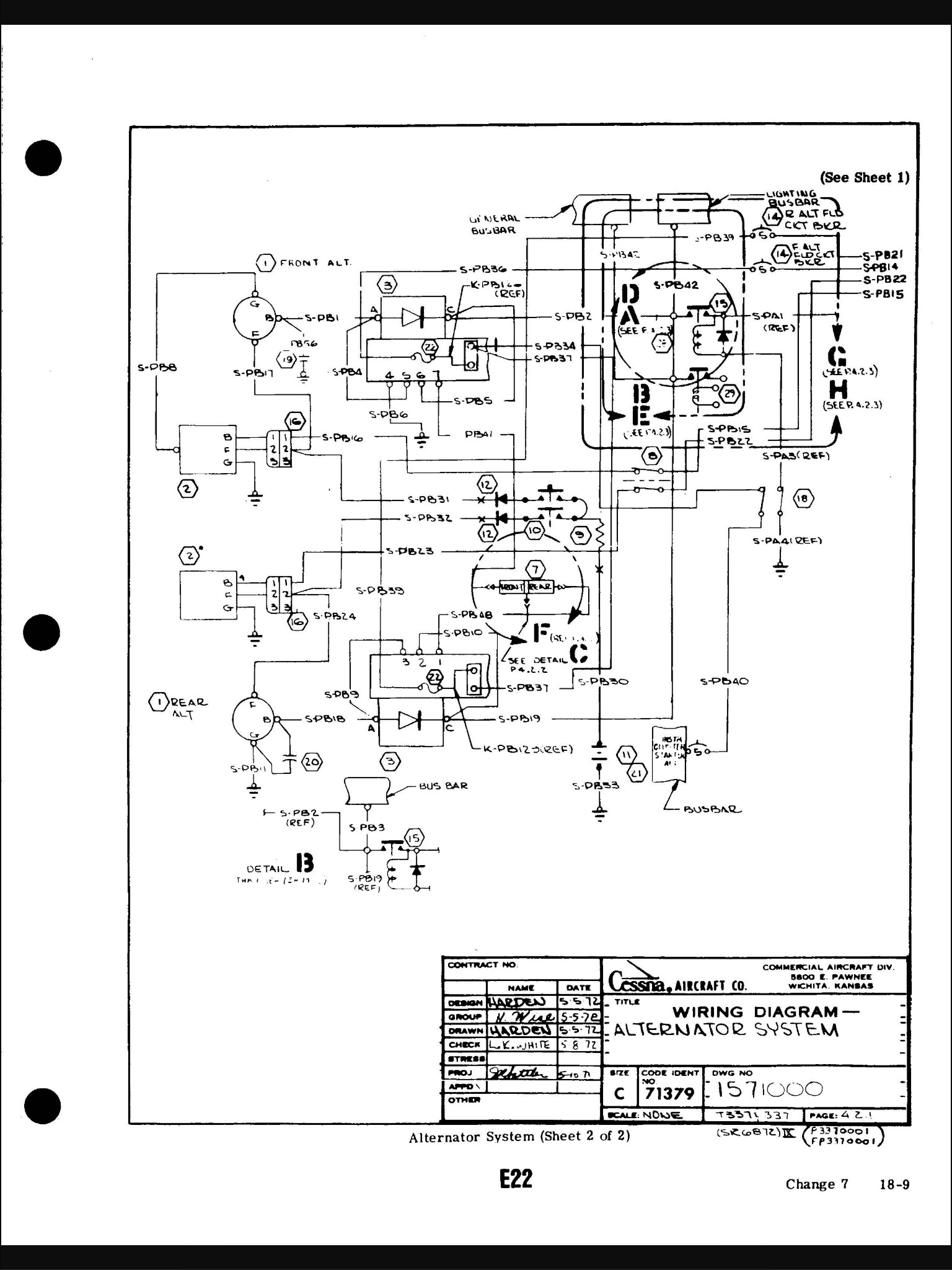

Hi Dave,
Thanks for looking at this. I have a Reims FT337GP, s/n FP3370017. It is the equivalent of the Wichita built P337G.
Attached is the schematic:
Rick

I just found the schematic. The alternator restart switch bypasses the regulators and puts power directly to the field terminal of both alternators. It comes off the batteries through a one watt, 12 ohm resistor. It is also interesting that each alternator has it's own regulator.

Yes, that is the schematic I have in front of me.

I had an alternator shop guy tell me a dead alternator only needs about an amp to excite the field.
Do you think a couple D-Cells could provide that after passing through the 12k resistor and a diode?

I would doubt that. Actually the alternator is not dead. The battery field circuit from the main battery is dead. It's a 12 ohm not 12k ohm resistor. Feel free to call me. I will PM my number. I'm working from home today and could use a break.
