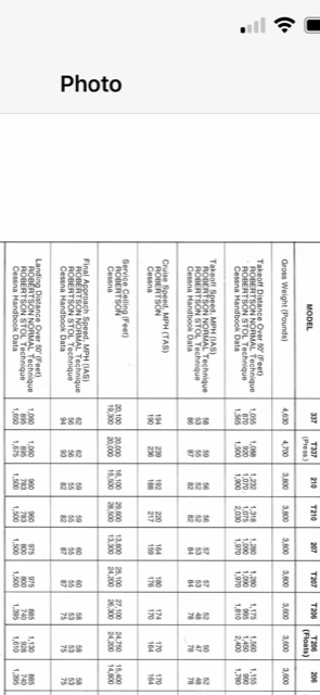

Here are some STOL speeds and landing distances from Robinson. I have only flown a skymaster with STOL and you can definitely get much slower that without on approaches.
File Type: png FB2C52F9-0412-46AF-BC90-A7DD721D4A88.png (851.2 KB, 1930 views)
