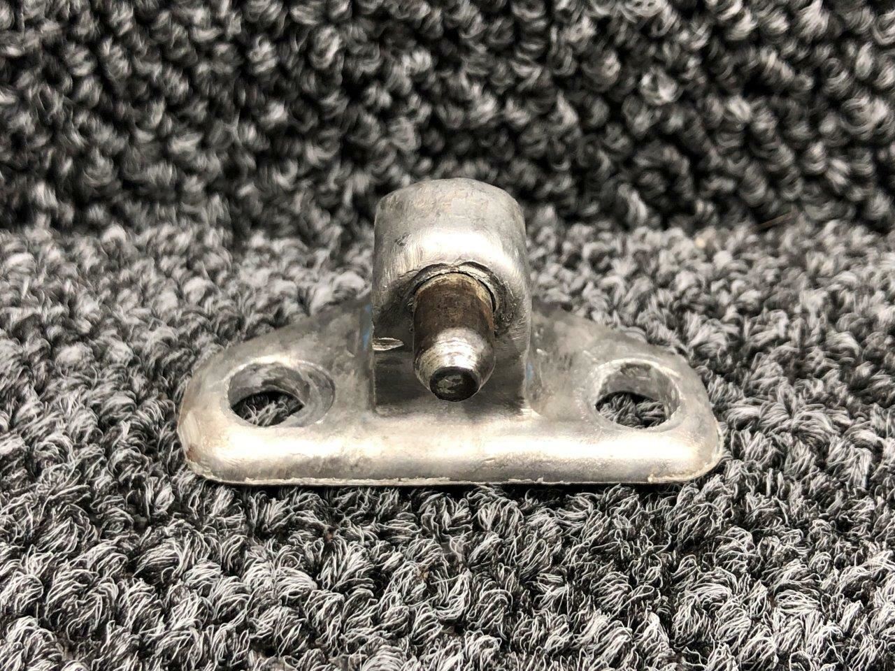

1511426-1 / 1511426-3 Cessna T337G Lower Cabin Door Connector Inner W/ Pin
If these are installed correctly I can't see how the bottom door can open without the top opening first. Regards, Joe
