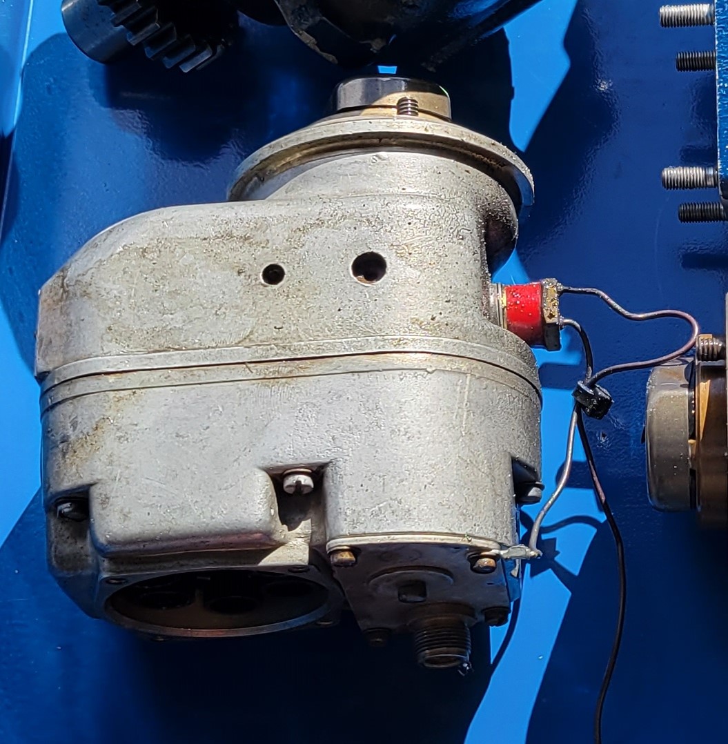

There should be a sensor on the mag This is off my 1967 337b
You can see it on the right side - the red sensor

Thanks to Tom, Frank, and Randy for your kind assistance. I was able to troubleshoot the system and discover that my sensor as well as my tach are functioning properly. The problem is with the prop sync transmitter or the wiring associated with it. I bypassed it by connecting my sensor directly to the tach and the tach is now functioning properly. Next I will troubleshoot the wiring associated with the prop sync transmitter and if that all checks out I will start looking for a replacement transmitter.
