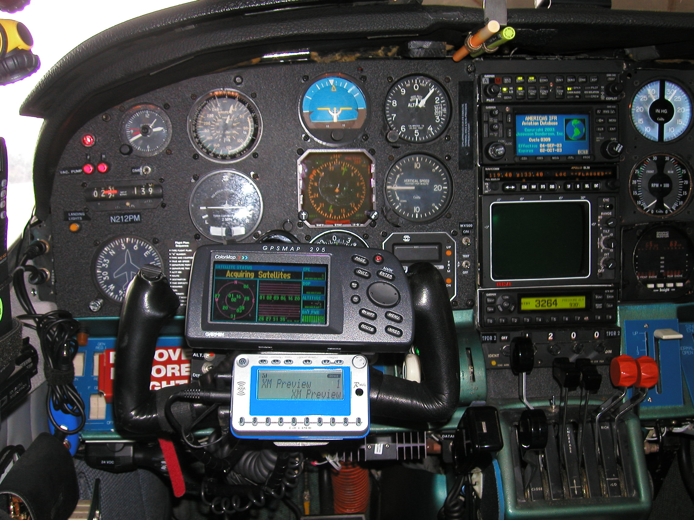

If you want to modify the existing 12 VDC cigarette lighter power plug supplied with the Roady just:
1.Open it and remove the 470mf capacitor rated 16 VDC and replace with PN:272-1030 rated 470mf at 35VDC from Radio Shack. Tight and tricky work with a soldering iron but simple enough.
2. Use a dremel tool or small hobby saw to cut cooling slots in the housing above the new capacitor.
A photo of my installation is attached.
