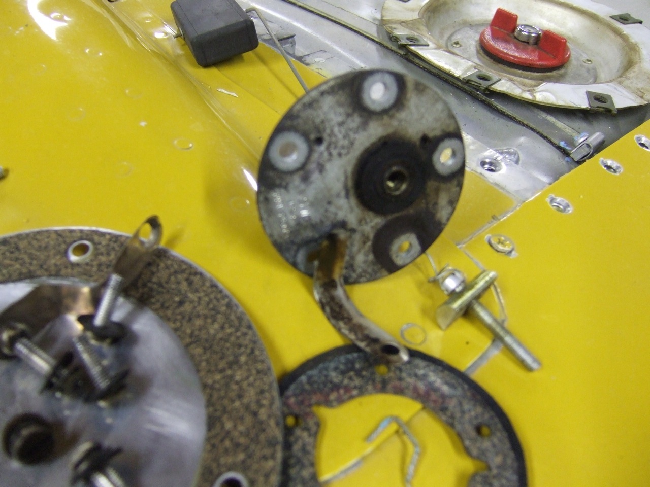

My 80-H was sitting for a month with minimal fuel in it last year and a few minutes after it was topped off all of the fuel started running out the two holes where the fuel supms stick through the bottom of the wing. If turned out to be the cork gaskets on top of the inboard wings(s) that are the tank inspection plates where the inboard fuel guage pickups are located. We sent for new cork gaskets, replaced, and the have both beeb perfeect ever since. Apparently as they age, if they are left to dry out (minimal fuel for an extended period of time) they start to leak.

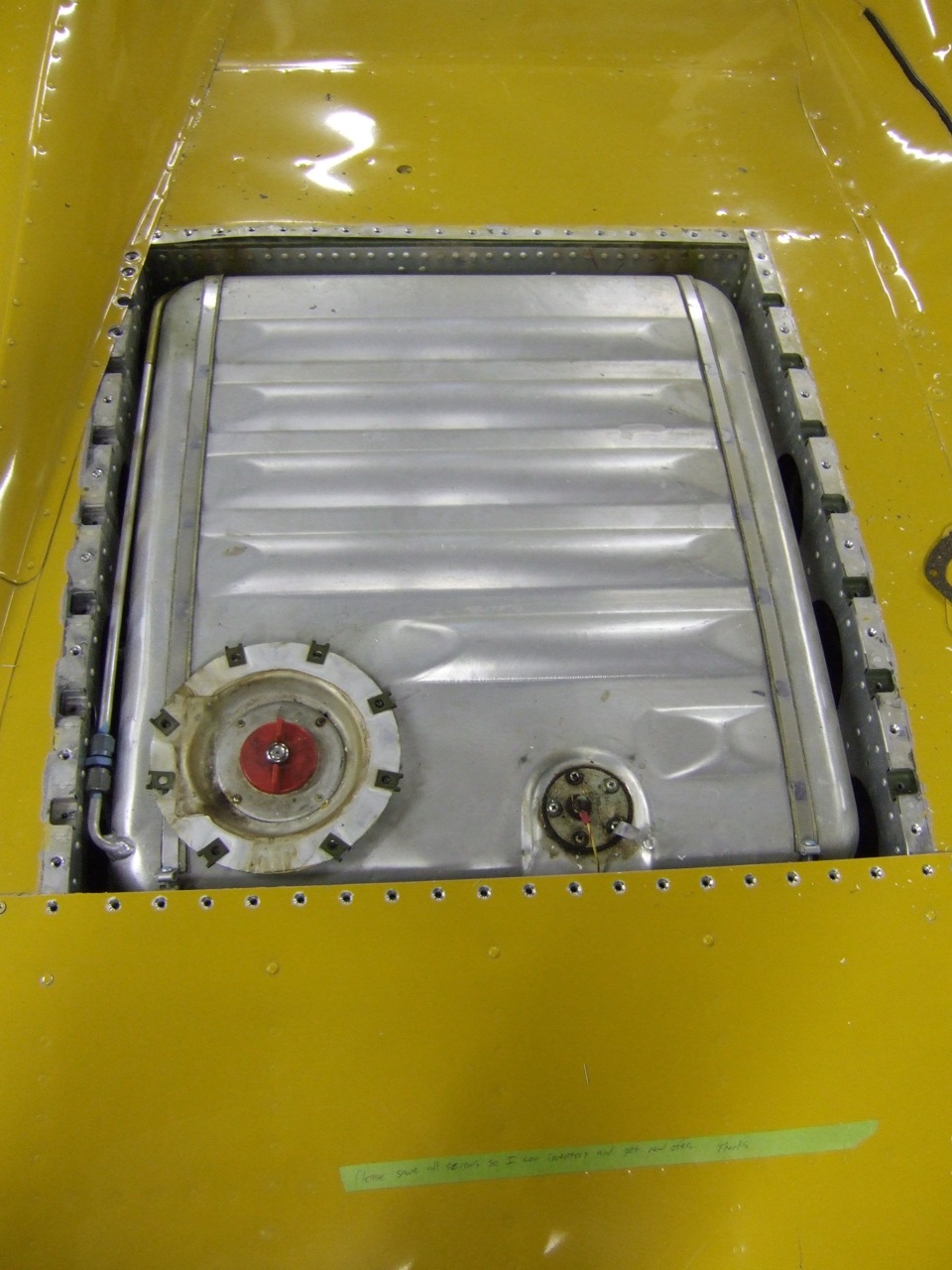

When I replaced my gaskets at the fuel sensor port I replaced them with a rubber type gasket. I am pretty sure I sourced them from Yingling in Wichita. I don't know if they are any better than the cork style but time will tell. I didn't have any leaking at the time but I was inspecting all the tanks so they got changed at that time.
I had to have one tank welded at the outlet fitting. It was welded by a certified welder in Kalamazoo.
Photo shows the original cork gasket and the other photo is the tank back in place with the new rubber type gasket.
Name:	Aux Fuel Sns.jpg
ID:	1066   Click image for larger version
Name:	Aux Fuel Tank.jpg
