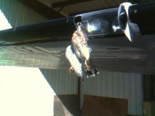

Dad killed a red-tailed hawk with his starboard landing light lens cover. Never even knew it until he started to put it in the hangar. The problem is neither of us have a parts manual handy(mine's 70 miles away in Nashville and his is in Naples). Does anyone know the part number for the replacement lens?

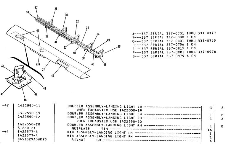

I think you want a 1422550-12 if your aircraft S/N is up to 337-0379 or 1422550-20, which is the more current number. But it's for the entire lamp assembly, and there's no P/N for just the lens. See figure below. Shouldn't be hard to find from yards that disassemble aircraft. Try Don Nieser first at 405-503-4686 or 405-722-4079.
